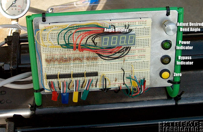

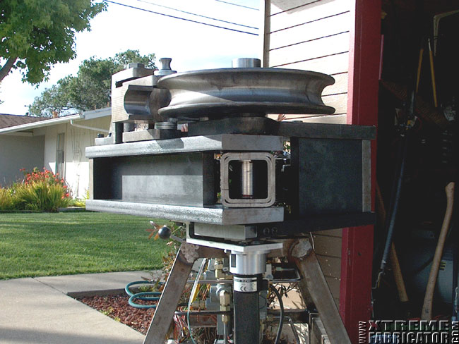

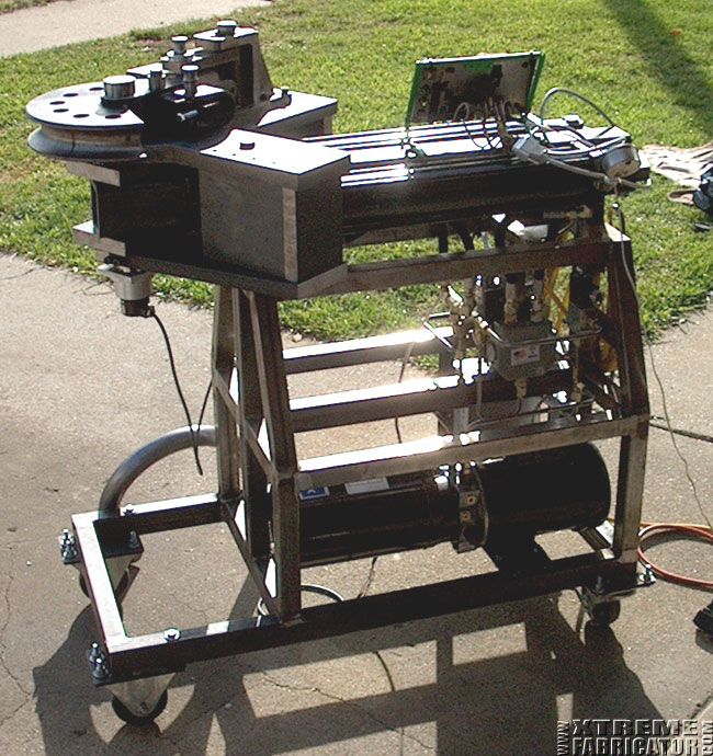

I wanted to post a few pictures to go along with the video above. I realize I haven't taken any pictures of the machine as a whole, so here are a few for ya.
(Below) First, this is what the prototyped user interface looks like. I labeled what the lights, buttons, and knob are for. The electronics aren't as complicated as they look; most of the work is being done by the PLC.

(Below) Here are some overall pictures of the bender rolled into the driveway. I have a lot more plans for the cart like panelling, shelves, and doors, but the main bending assembly is pretty well finalized.
