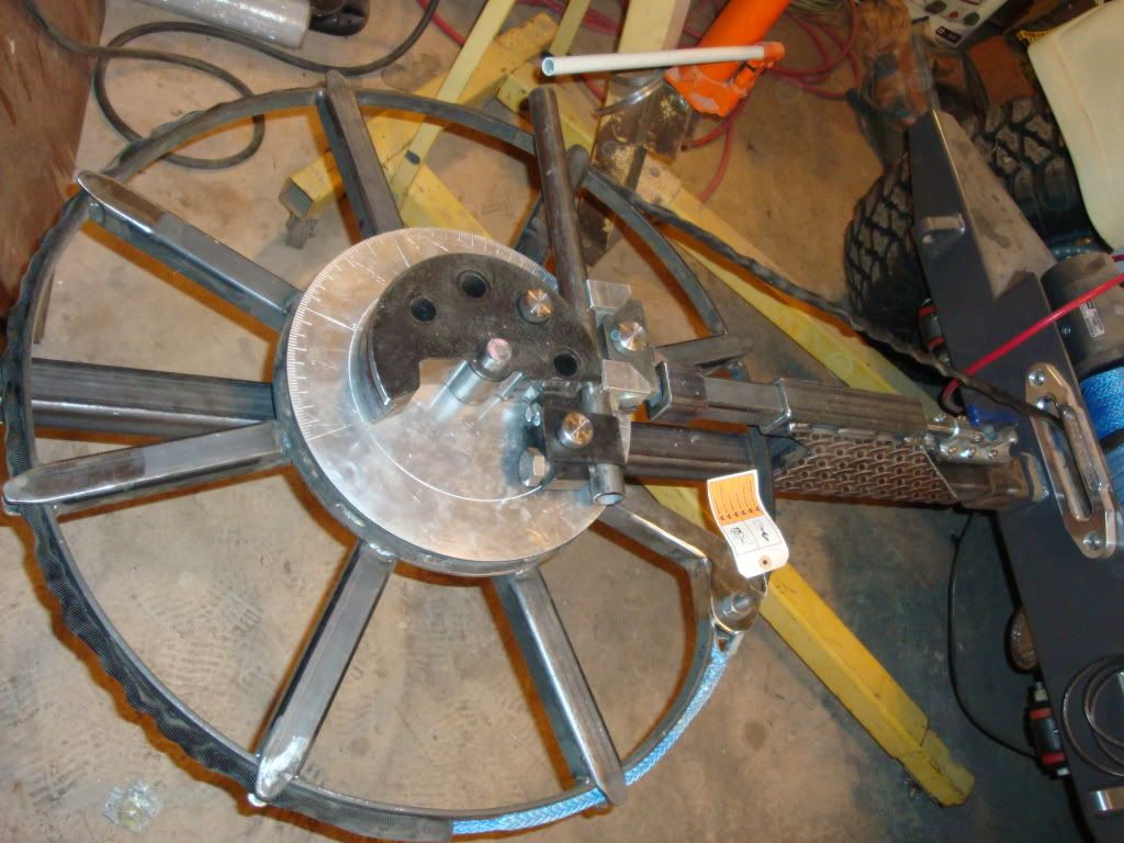

Originally Posted by TheBandit View Post
What method do you currently use to drive your tube bender? Please respond to the poll and tell us what you think of your drive method.
Other
just noticed how thisset up works. thats rather clever i thought. Using his winch and receiver hitch as a stand and driver.
