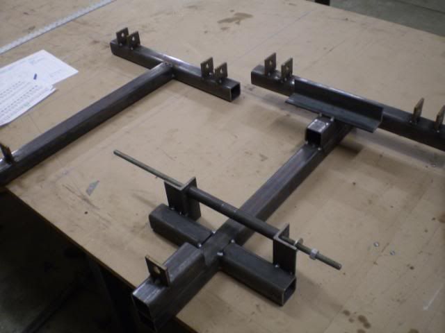

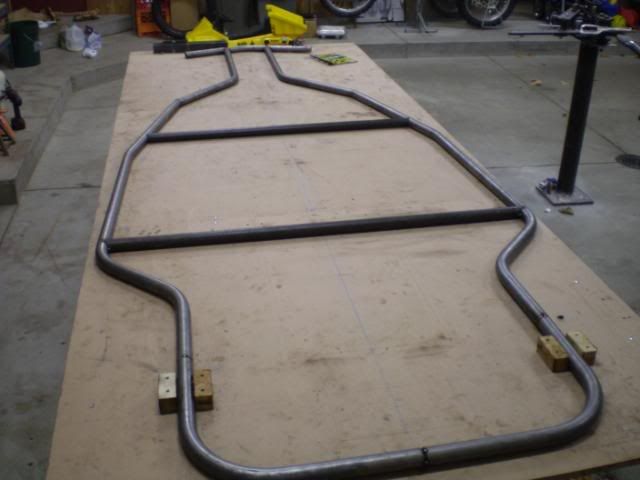

Here are some pics ig by 2-seater build!
The mid rail
The front a-arm jigs
The mid, and lower rail coming together.

Well all I have done this week is weld at night after my son goes to bed. I DID however get my wheels and tires. Here are some more pics....
