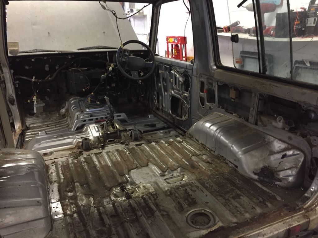

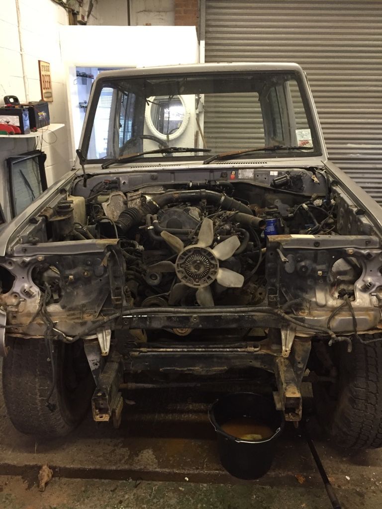

Next mission was to strip the interior and get the old 2.4TD lump out.

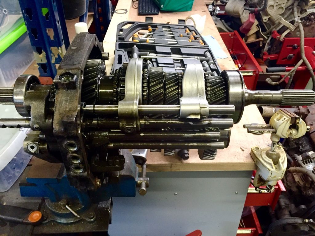

After that I rebuilt the R150F Gearbox and T/Case.

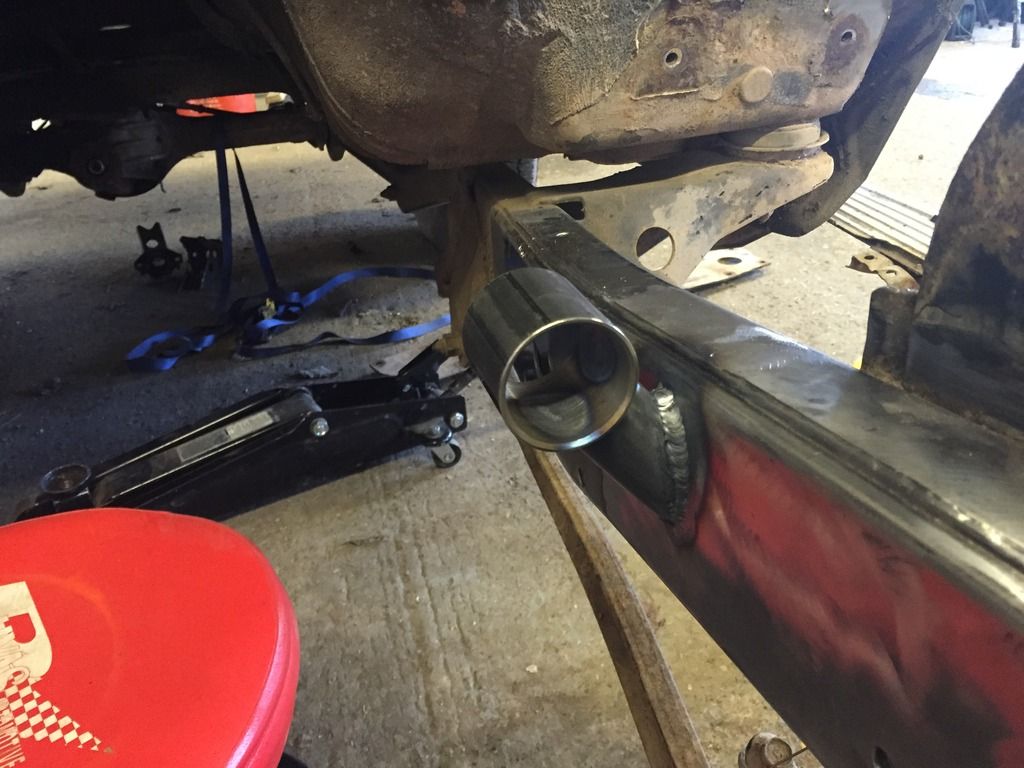

I was thinking I probably should have welded a section of plate on the chassis rails before welding the engine mounts on
I would definitely do that! I have put a 3Liter V6 in a Samurai and doubled all the chassis mounts. I forgot 1, the Panhard bar mount. 2nd race I drove, it came out of the chassis.... lesson learned...

Basically horizontal triangle piece top and bottom attaching chassis rail horizontals to your mount,it will flex otherwise ,im a Patrol fan,great axles for sure

So progress has been super slow. I had a steering shimmy of sorts to chase down on my 80 series Landcruiser which took a couple of weekends to resolve and then a short break away to appease the wife. Like they say happy wife, happy life. Right...
Anyway I decided to cut out the mounts I made up for engine and plate the chassis rails. I'll be kicking myself own the line if the mounts fail. But first I decided to fab up a welding trolley. I recently invested in a MIG set and soon became frustrated with hauling that and the TIG set around my workshop.
Anyway, onto the chassis plating. So a bit of work with the plasma cutter and a drill I came up with this:
Then proceeded to TIG weld it in place, which was somewhat awkward with no where to rest my hand so not the neatest TIG work I have done.
I haven't done the other rail yet, thats this coming weekends mission. I am thinking the MIG may be the easier choice from a weld position point of view, what do you guys think?

Good work Thomo,forget TIG for this work IMO,not necessary at all

I fishplated the other chassis rail and I confess I MIG'd it. Which I sort of think in hindsight maybe I should have stuck with the TIG but is was quick. I had the volts turned up pretty high and felt I achieved decent penetration. Time will tell I guess...
From some reading I did on the forum I realised I should avoid Vertical welds when fish plating. Also this time I went with bigger holes for more weld.

Great work Thomo,Mig is fine don't worry,I cut a 70 down a while back,challenge type build,what plans for rear of cab?

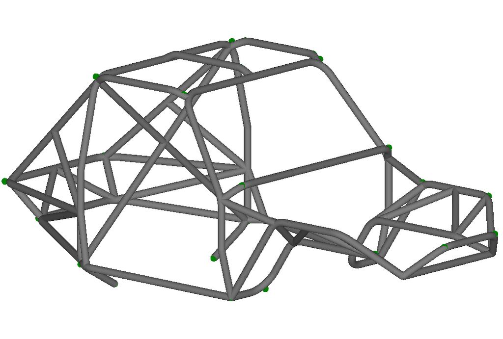

Plan with the rear is to build a tubular frame of sorts to mount the Radiator, Fuel cell, spare wheel and somewhere to keep recovery gear.
I had a play around in bend tech and this is loosely based on the cruisers dimensions and is a rough outline of what I am shooting for:
Side View

Read well the ultra4 regulations before start building. I believe they require a 1 piece tube along the door. See red line in pic...
I'm also thinking of competing the euro ultra4. Maybe modified or legends class. My cage is also build as you drew it (almost :) ). A tube along the front window. Last week I was at the king of France race and talked with some participants I know and they made the remark my cage would probably not pass technical inspection due this issue...
Hey Peter,
Thanks for the heads up. The rules don't seem to be explicitly clear with regards to the cage. My understanding was that the guys who have built vehicles that are both MSA and Ultra4 compliant have the A-Pillar Hoop. But I know that the MSA and Ultra4 Europe are no longer affiliated so I need to do some digging on the rules. I am not particularly fussed about MSA compliance but if I could be both MSA and Ultra4 complaint that would be cool. From looking at pictures form King of France it does seem like a lot of the competitors cages were the way you marked up my design.
In the roll cage section the only reference to a door bar or the orientation of any of the bars is in rule 7.10 which states:
"All vehicles, including those with stock steel doors, must have at least one side bar on each side of vehicle that will protect occupants from side impact. The side bars must be of the same tubing material and dimensions as the main frame of the roll cage. The sidebars should be as close to parallel to the ground as possible, must be located to provide maximum protection to the occupants, and must be securely welded to the front and rear hoops of the roll cage. The location of the side bars must not cause difficulty in entering or exiting the vehicle."
I have emailed queries to the tech director of Ultra4 Europe before and he has been pretty good and responding so I'll be sure to touch base with him on this before I start with the cage.

Looking great Thomo,I think once you are keeping the majority of the chassis then regs are a little different/easier..U4 is Defo easier than MSA IMO,more cross bracing though regardless but looking good
