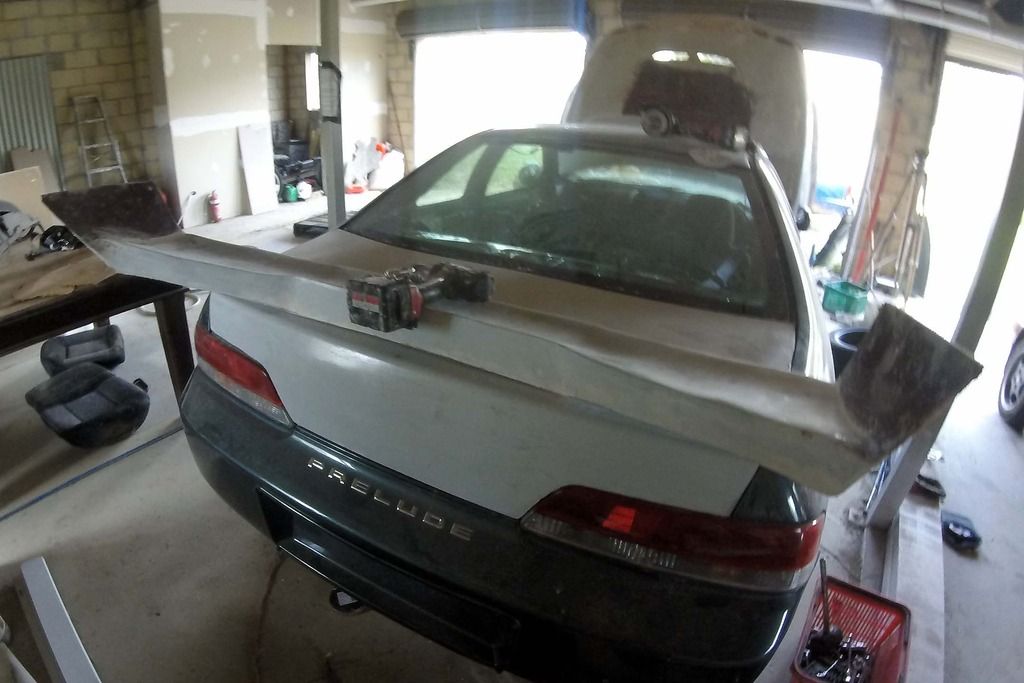

This morning I layed up the top side of the woven cloth I put on the underside of my rear wing yesterday. After lunch I trimmed it to fit in position behind the boot of the Interlude where it's angle will be adjustable. Is it big enough?

I use un-expanded Rivnuts to mount my wings. I dig foam out of their ends and epoxy them in place, covering the whole wing end for max strength.
