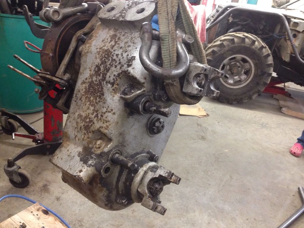

Np 205
Can anyone please identify this transfer box/case for me ??i was told its a 205 and looks very similar in a lot of ways but still sie differences like steel bearing caps,4 extra bolt holes on PTO cover etc,im guessing it's bery old but no expert either so here it is and see what ye think has band type park brake on output yoke

Inserting, my first glance is early Dodge Divorced 205.
My second glance makes me question my first glance but I'm going to stay at 205.
Picture of the PTO cover?
Case is Iron, yes?
Two speed case?

Thanks E,yes it's 2 speed with low ratio cast into case 1.9# :1 and solid cast iron case with cast or steel bearing caps on input and outputs..I'll pop out and take a couple more pics and post right now

It looks to me like a very early NP205. I had a 56 Chevy pickup that was converted to 4wd for the forest service that (from memory, 20 years ago) had the same t-case and when I got it I had to reseal the input and all the seals were still available. They are ridiculously heavy.

Thanks Jaysin,certainly is heavy!!!i 2 man lifting ,opened the PTO cover and looks good as new inside ,i picked it up to put in an old J20 project im gonna start soon,hard to find divorced transfers over here,hard to find any transfer that will take a bit if torq

I'm going to stay with early 205 out of a Dodge possibly military application.
that said I could easily be wrong.
Look for the ID Tag though it is likely long gone.
Try running the casting numbers through Google maybe?

No ID tag im afraid just some numbers in casing,G92501Q with smaller numbers above but I can't make out..now I've searched and could it possibly be a 200 or 202?

Strike that,the 200 doesnt have PTO and 202 has selectors vertical ...can't find any 205 with that PTO cover and cast bearing caps though

here is a link with a picture and it sure looks like what you have less the PTO...
I'm thinking I R Wrong about the 205 at this point...............

That's more like it for sure E,identical except for the mounting points...trust me to find a 201 !!but sounds like they are decent and durable

Dodge or IH NP200, 201 or 202. There was a PTO that used 10 bolts made specifically for the the 200, 201 and 202 made by Braden Winch.

It's defo a 201,done a lot of research since..now looking for a 200 gear to replace the factory "knock gear" 😖😖

Me to until recently,the rear output shaft is a 2 piece design with a spring cousioned gear arrangement which seemed to have a 100% fail rate,apparently it knocks like hell..some have been welded solid
But most seem to fit a 1 piece gear/shaft from a 200
