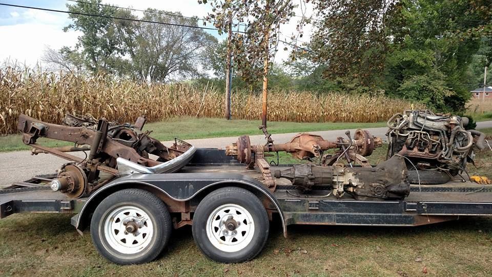

Picked up this '87 F-250 drivetrain for $400. It had a Dana 50 front, and Sterling Rear, ridiculous overkill in the rear, but should not need any strengthening to hold up indefinitely.

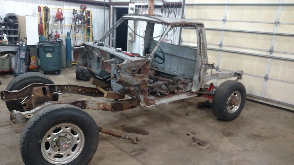

Mocking up everything, I had the frame down to only a couple crossmembers and the rails. There is no standard rulebook, so I printed off about 6 sets of rules just to be sure I wouldn't be re-doing something later. A few tracks have wheelbase rules, so I targetted 120".

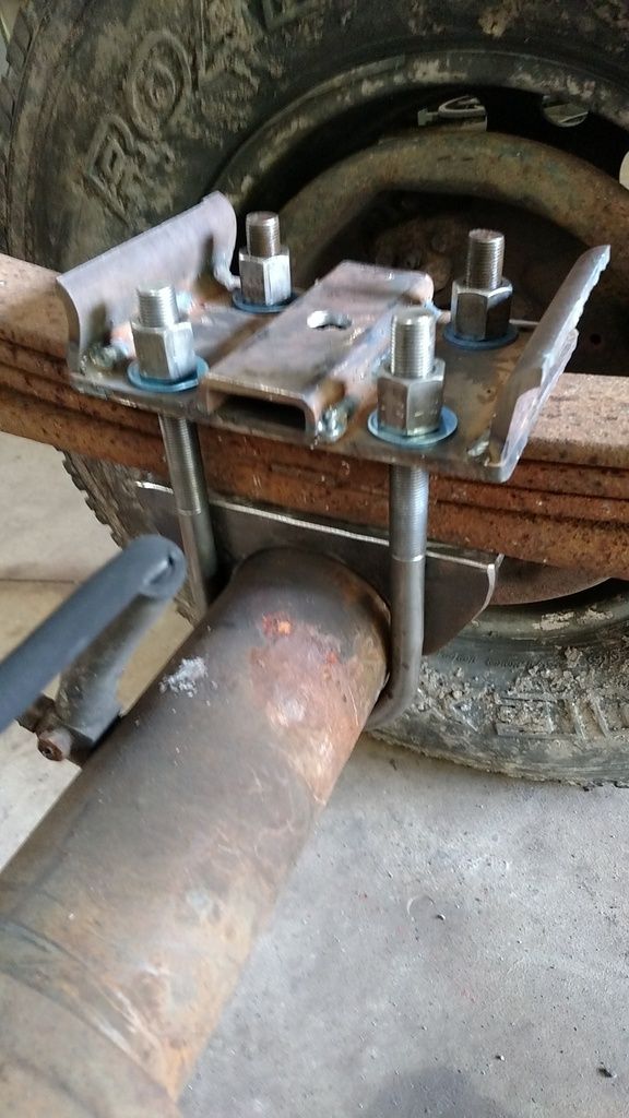

Using CAD (cardboard aided design) to put together a leaf hanger.
Pretty pleased with how it turned out.
Also built spring mounts and plates. It turns out I'm working for $4 or $5 dollars an hour doing this easily available stuff, but its therapeutic and mine.

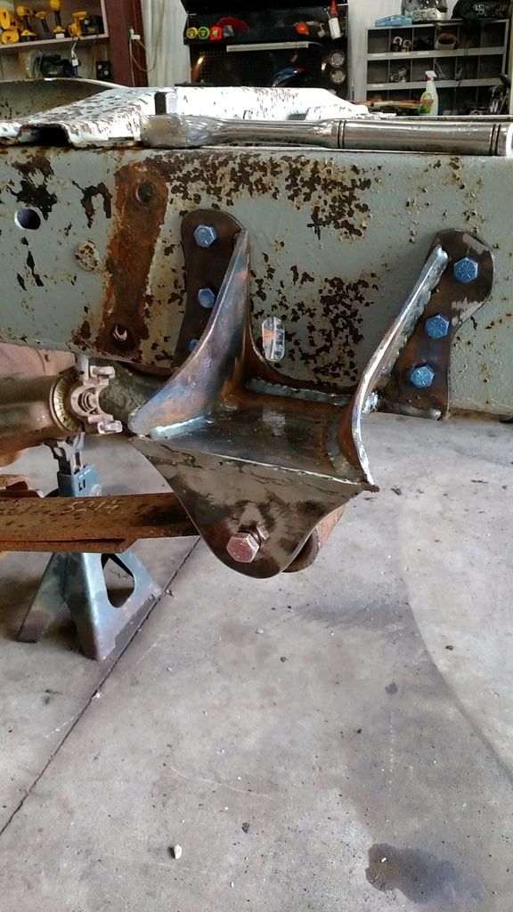

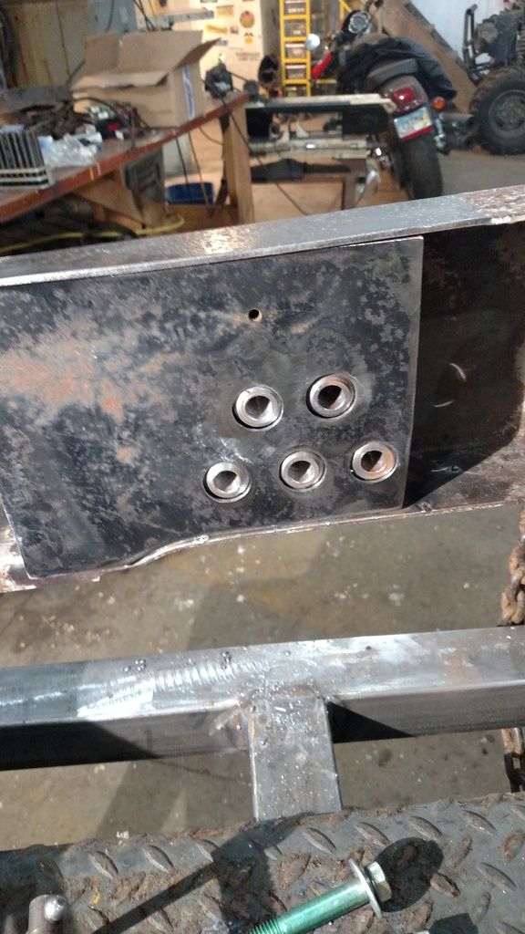

Front end got ~42" radius arms, and built these RA mounts.
I made sleeves for each of the bolts. and plated the frame at the mount.
A lot of my reading was Carroll Smith, so I have been doing the sleeved double shear mounts he prescribes in his nuts, bolts and fasteners book. The TTB arms got 3/4" uniballs and the same sleeved double shear brackets. The lower ball joint was cut out and moved 3/4" out and about 1/8" forward to improve camber and caster.

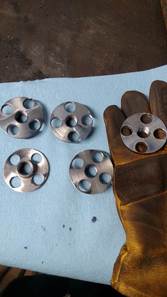

I needed some threaded holes to mount my radius arms to the beams, so I made these inserts to weld in.

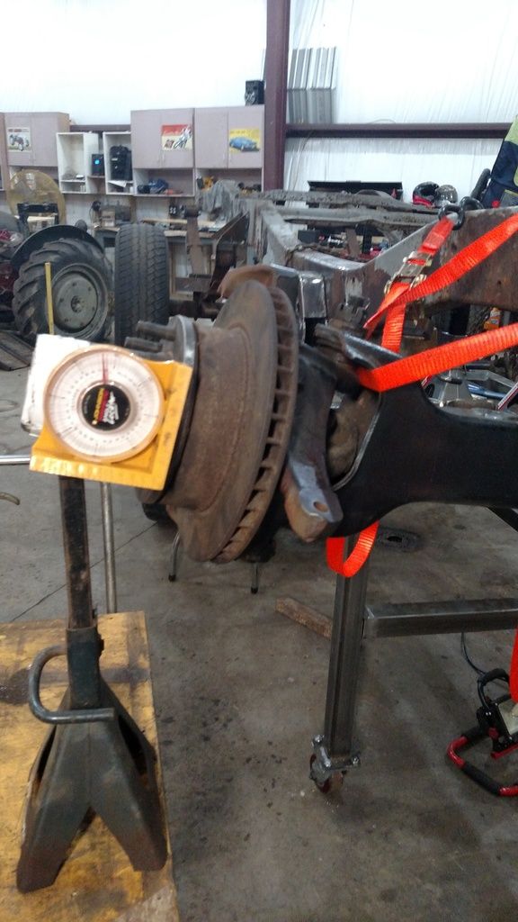

I cycled the front end over the 14" of travel I'm allowed, it only goes into negative camber at full droop, so I feel ok about that.

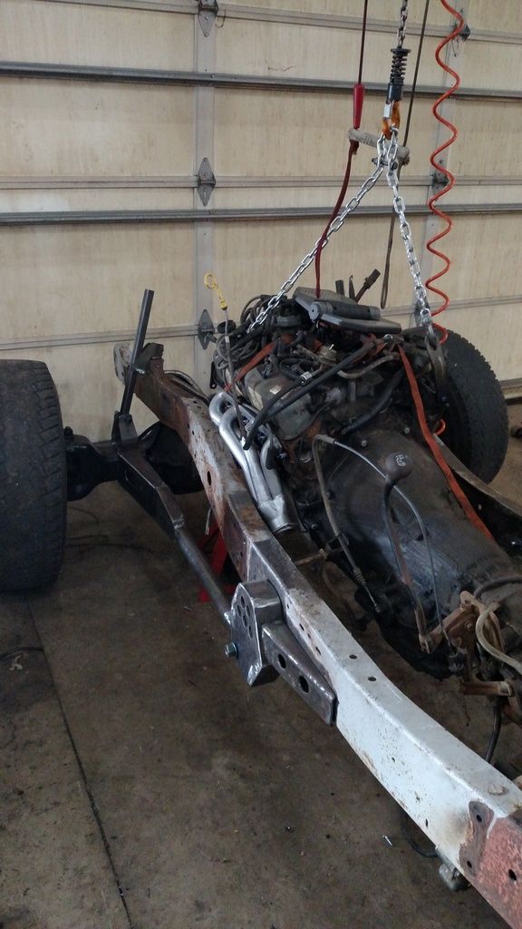

Engine mounts are just a poly bushing in a double shear mount, with square tube triangulated to a plate welded to the frame.
Fitting up the powertrain. The engine mounts are moved back about 9" from factory, and the front axle forward about 6". The firewall will get heavily cut and patched to fit the engine.

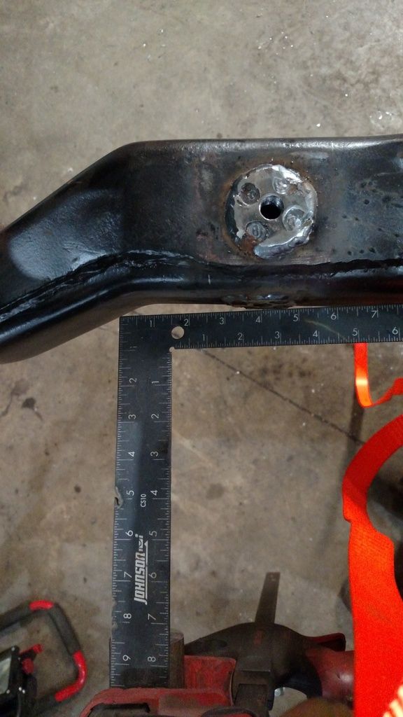

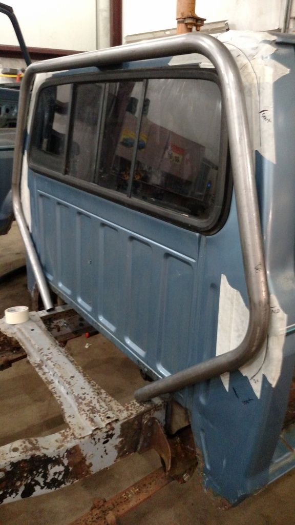

Main hoop looked great, but I wasn't totally happy with where the landings fell on the frame. I got it fixed, but next time I have a critical tube I will be sneaking up on it so I don't have to do an opposing bend and make it look so damn hokey. It was 3 degrees, but it looks like a giant pimple to me.
Side question: Who makes a good plane of bend bracket? I did of with an angle gage, but it could be better and easier.
Tweaking the main hoop. Not happy about it, but wasn't going to toss an expensive tube over a problem that can be addressed by gussetting and good design.

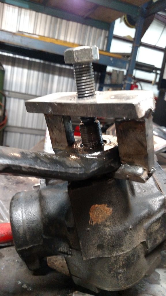

Bouncing around to the steering: Revision 1 of a shop built puller wouldn't do the job. I knew it would be a difficult part since it has likely been mounted since 1987, in the Ohio salt and gick.
Shop built puller #2 did the job, but not without heat. I realize this is bad, but it'd getting welded anyway, and the whole box was useless with it attached.

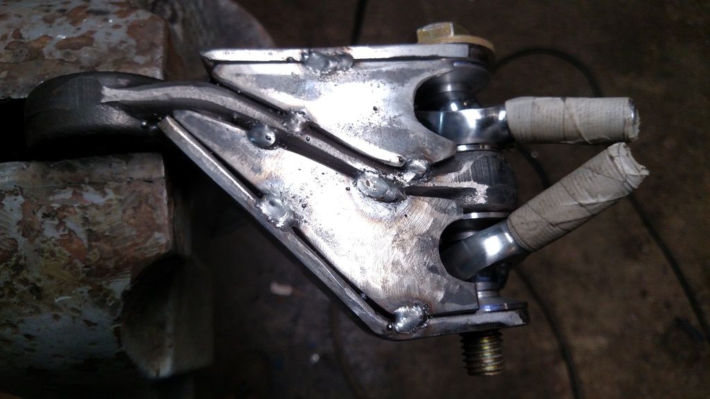

Got the double shear pitman arm bits tacked in. It's going to need clearancing, but it clears in all the external ways it needs to.

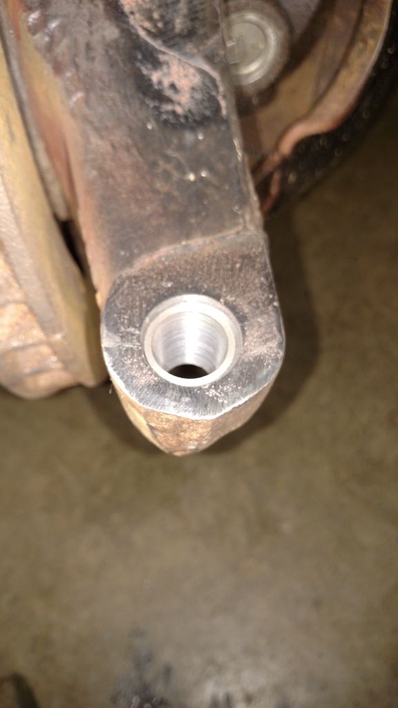

Drilled and sleeved the Dana 50 steering arms for 1 ton TREs. I believe they are ES2010's from a Chevy or Dodge application. I'm marginally confident the arms will hold up, but Dana 50's are a dime a dozen if not.

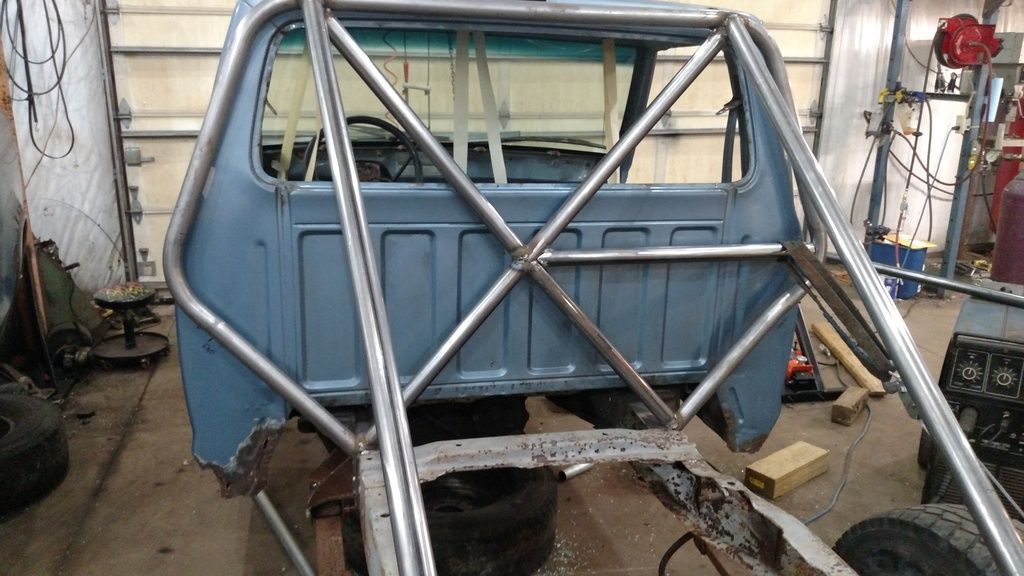

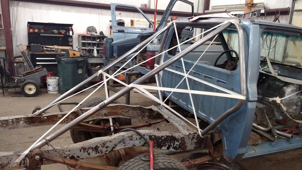

And back to the cage. I like having a couple things in process so I don't get too mired down in the minutia and at least got something moving if I'm waiting on parts, money or inspiration. You can see the opposing bend in the main hoop. I guess that's why I did my own cage first.
Classic "Tape that oughta be tube" shot. The back half should't be difficult, I'm just using bed skins, and the battery and fuel cell can be put wherever they fit, at least in my mind.
Where she sits right now. I'm digging tube work, you can make big changes relatively fast.
I'm kicking a couple ideas around on the front section. I think the front down tubes will land on a rockslider type tube that will tie into the frame in front of the radius arm mount and return back to the main hoop. Going to the frame would be better, but it is too close to the center of the vehicle. I have no faith in the integrity of the body panels, so I'm dismissing the idea of going to a floor plate out of hand.
Putting the main hoop behind the cab frees up precious interior space, but doesn't lend itself to a well placed harness bar, so that will need to be addressed as well. I'm also not certain what the best way to bend shock hoops with a 90 degree die is. Just put two bends as close as practical?
