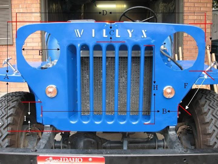

I have more but photobucket isn't working for me right now. I have all the dimensions shown in this photo. I'm have a scale picture of the radius of the grill.

I actually got all the measurement saved where you see the dimension lines. I used those dimensions to create scale t figure out the outside radius and crown of grill. Right now I'm building a press tool to create the slot radius using similar designs of chassis punch. I don't have a press big enough to stamp it so I'm going to sandwich between two shaped plates and compress with large nuts and bolts. The slot widths are 1 13/16 " and from what I figure, approx. a 3/16-1/4" radius. Obviously I am not that concerned too much with that. Basically, I want you to think it's a flatfender from 20 feet away. Certain details like the shovel and axe notches on the driver side I'm not doing or a tailgate. The only lights I need it to have to be a legal off-highway vehicle in Alberta is headlights and tail/brake lights which I'll do.
