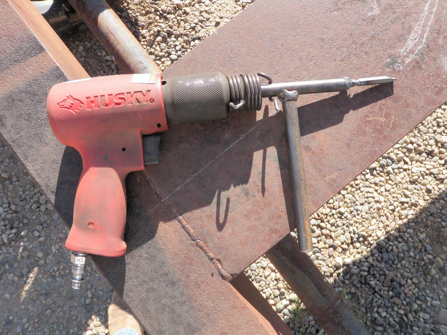

I don't know if you guys have used one of these or not, but they knock out old slot screws really quick. Just weld a slot screw driver bit to the end and rotate the handle while you run it.
I really like this idea. Looking forward to all the updates.
