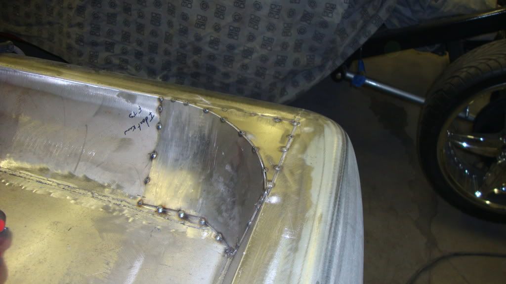

  #27

english wheeled corners

Very cool... Whats the material? Are you going to fill the center with a hatch or are ya going to show off the frame work? Looks cool, I like it a lot. Whats it going on? And by the way WELCOME!

Body lines look like an S10.
Bed looks very clean.
