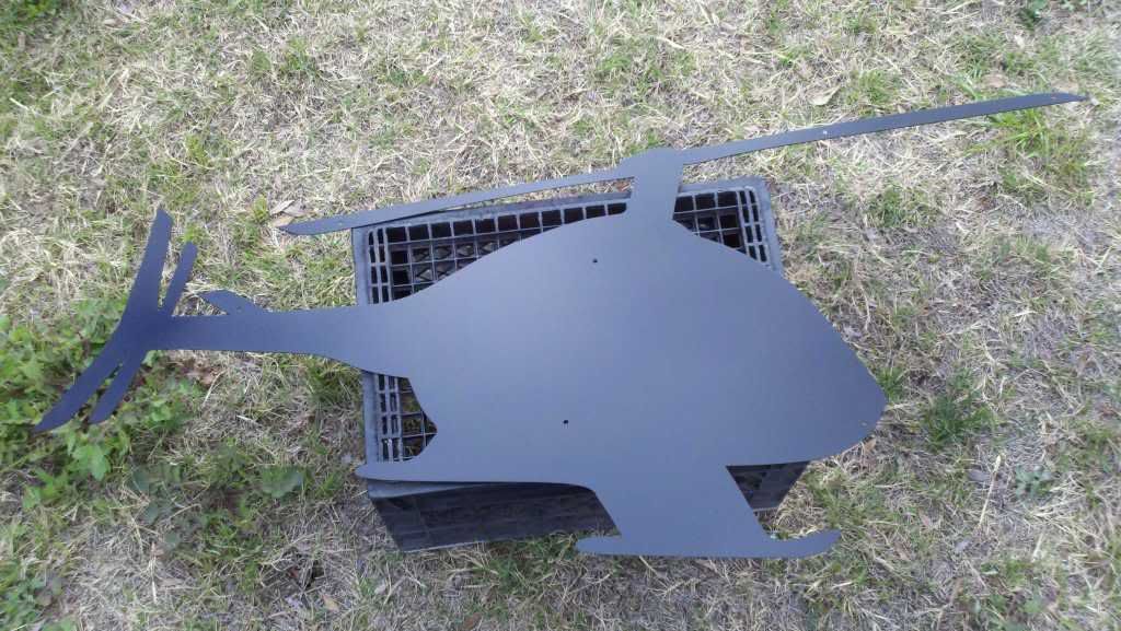

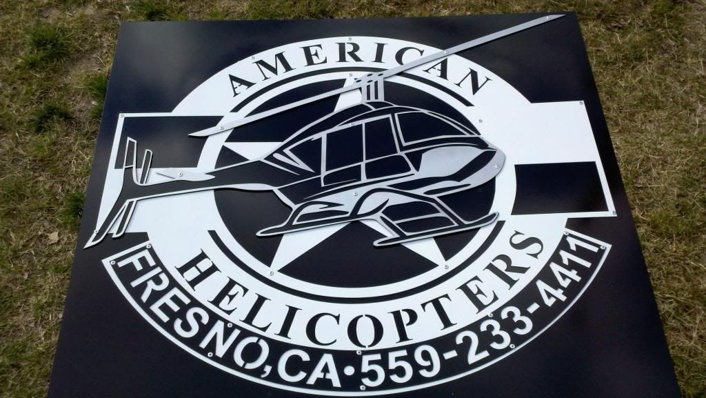

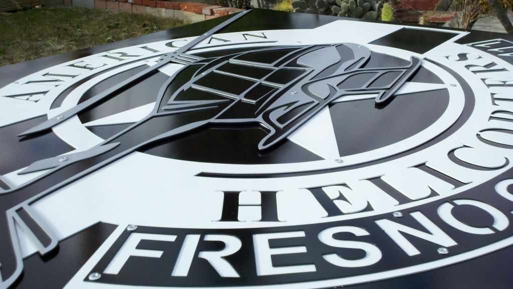

Originally Posted by Graham08 View Post
Wow! The chopper sign is impressive. Nice work!
Thank you, I still feal very new at this but its alot of fun.
Originally Posted by Captainfab View Post
X2.....You seem to stay quite busy with this cnc plasma work.
It seems each job I do gets me two more jobs. The word of mouth is great, but I need some buisness cards or something.
Originally Posted by TheBandit View Post
That is awesome! For assembly, you could drill holes in the bottom/back layer and rossette weld. Or get a spot welder.
I was origionally going to do this but I had to paint both sides of each piece so it wont rust. I was worried about the paint bubling and stuff so I went with rivets.
I had to get on a ladder to get this last pic. Its huge!
