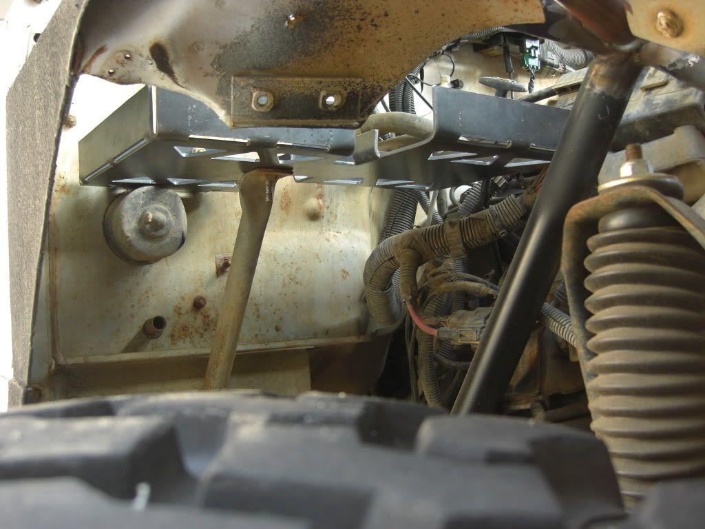

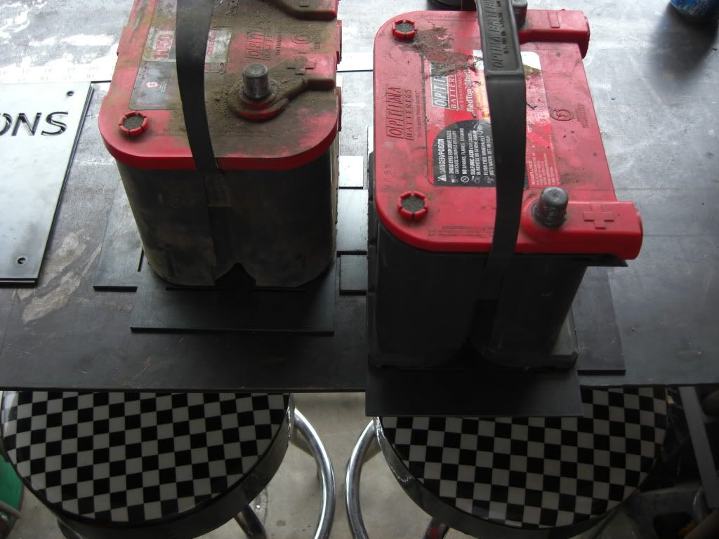

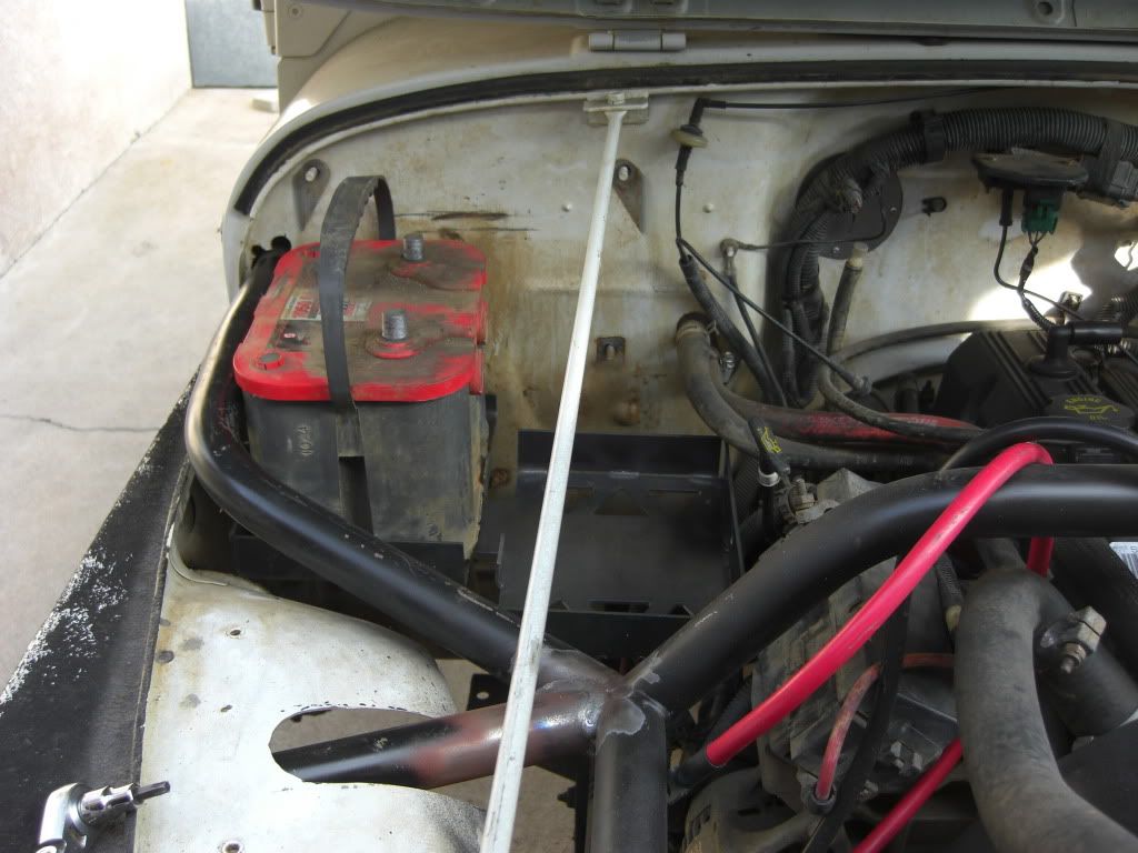

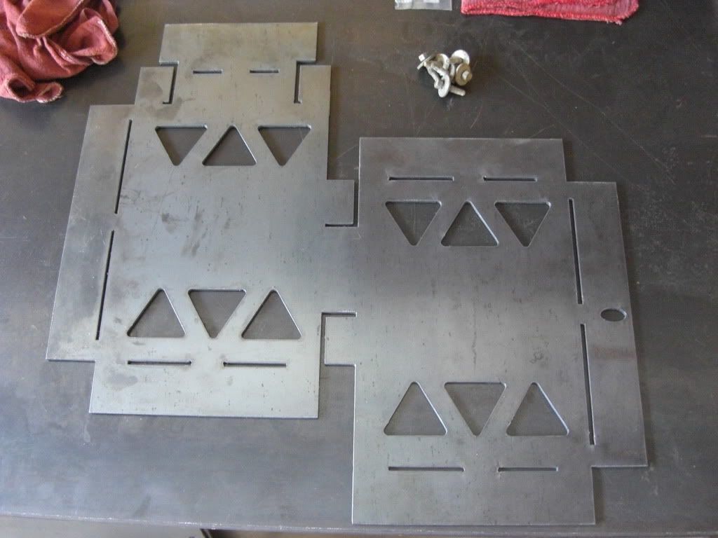

Captain, it changed the way we think about making parts and the new "no limit" to the imagination.
Had some more fun with it making a dual optima offset batery tray for a yj thats been rusting in my driveway for a while. Just need some support pieces and clamping thingy for the top later and it should be sweet.
Designing in 2D takes some effort but we got it on the first try.

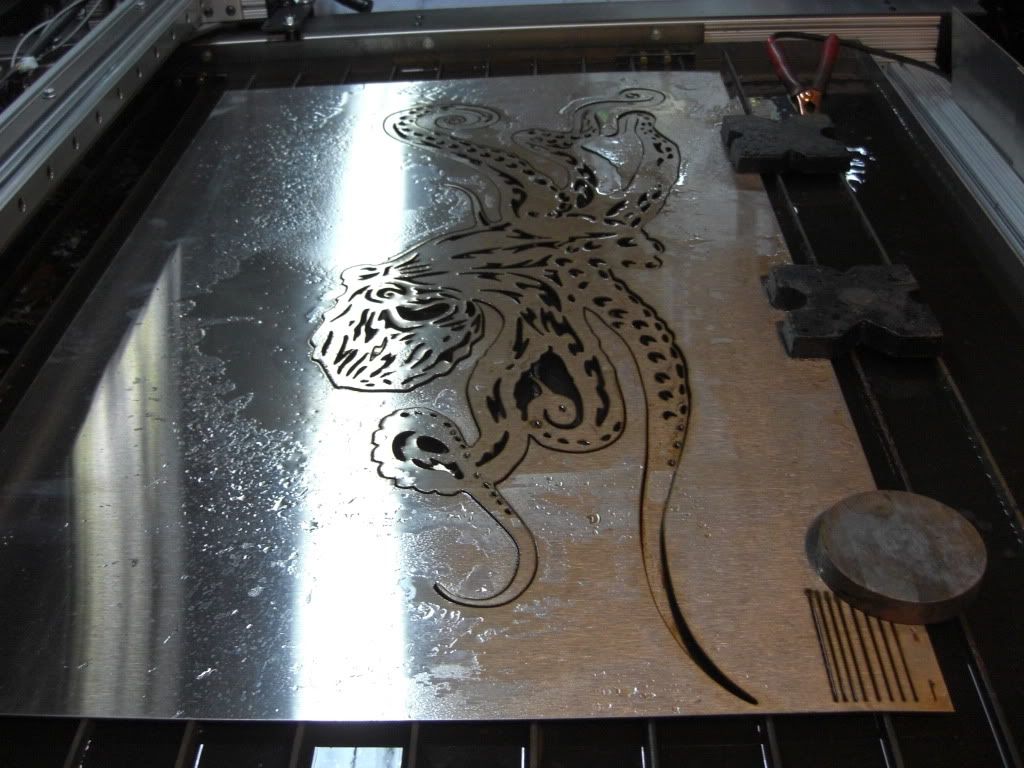

Air plasma stainless?
What do you guys know about cutting stainless on an air plasma. Is it ok, or do you need special tips or something? Got some requests for stainless cutting but dont know $hit about it. Infact I dont think I have ever done anything to stainless before. Any help would be great.

Looks good Scootek...im definitely jealous
Lay the stainless and burn...no need to change tips...
Love the battery tray

^^^^Yep just cut away.....nothing special required for stainless.

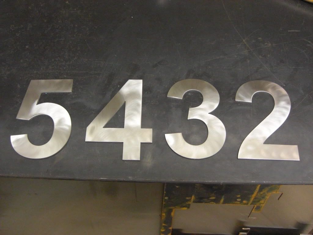

Finally cut stainless and it worked out great on the same settings for 1/8 mild steel. It left a super small slag line on top and bottom. It zipped of with a stripping wheel. The cutting process gave off a bit more smoke, and sounded wierd while cutting. The cut edge was good but looks like rust before cleaning.
Some house numbers.

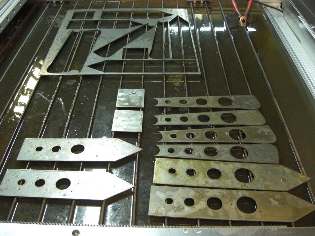

Also got some f-150 bumper brackets made up. More on this build later.
