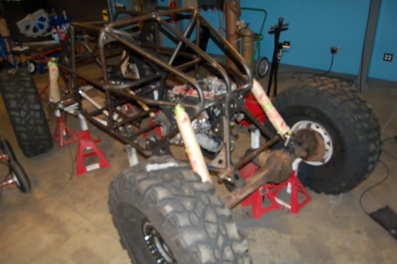

Some changes were made in the front and rear of this from Rockapes original.Rockape definitely did a killer job with the original chassis but are those tweaks your or his second version chassis?
The tweaks are all mine, I liked the Rock Ape version but once I had the tube bent and in place it just didn't jive with how I thought the buggy should look. So I made a few subtle changes nothign too over the top just mainly the front stinger and the new front "fender tubes" I think it looks a little more like a sports car now....
Coolest thing is that the principle measurements on this buggy WB, Track, are the same as the Diesel powered zuk I built before.

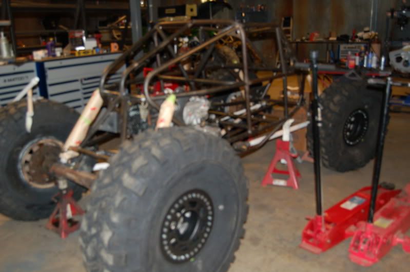

Quick question... In the event that you need to pull the engine/transmission for work how are you going to get them out? It looks like you've encased the power train in DOM which will even make it difficult to paint. Or am I missing something?

It can come out the bottom like alot of crawlers, or the top. The center tube is removeable thanks to some tubing clamps from Ballistic Fabrication http://www.ballisticfabrication.com/...mp_p_1467.html they work really well, I find I use them on more projects now that I have easy access to them.

UPdated pics
Shot from the rear
7075 aluminum links
Ballistic Fab "hybrid" air/coilovers
Nice AZZ
Sample of the chassis paint.
