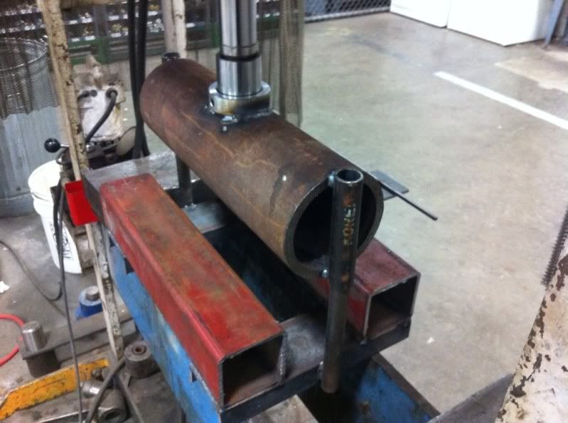

To make it in a press you would need something like this- but on a smaller scale.
An your center die would need to be the inside radius you want the taco, and the outside dies would need to be wide enough for the center die plus two widths of the said material that is to be bent. And press all the way through to 180°.
I bent mine by sticking a tube of 1.25" DOM tube in a vise, and using my hands to bend the 16ga sheet steel around the tube.

Ah, very nice, thanks. Had a similar idea, but much more complicated (with round rollers outside instead of the rectangular tubing). Easy is better :)
